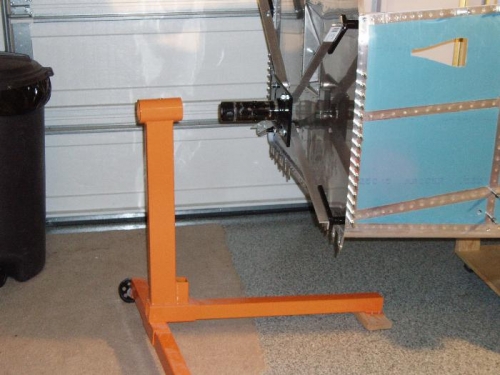

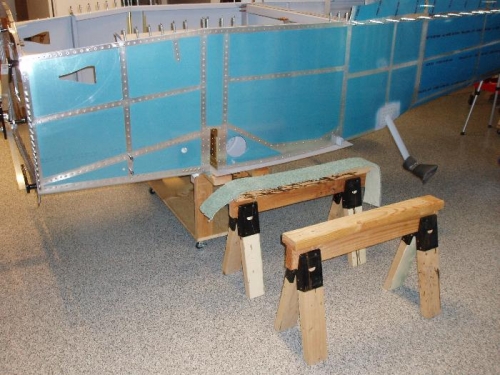

First I gotta do is remove the rotisserie stand and make a sturdy saw horse under the wing box to hold the fuselage level and secure.
Then I made a few small saw horses to hold the wings while I slide them into the fuselage.

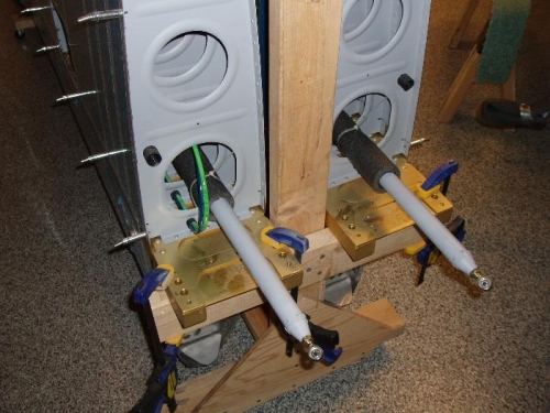

I put some pipe insulation on the aileron push rods and wired them secure so they don't bang around during wing to body mating. I also had to move the pitot tubes so I just pushed them back into the wing.
Remove rotisserie stand
Make saw horse to hold fuselage and wings
Secure the push rods & move pitot
