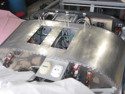

We did the plan. Rivetted top down. I squeezed the forward edge on the firewall.
I found various ways to lay inside and get a bucking bar on most of the rivets. All the rivets we did were great. We bent one, so I drilled it out and re-rivetted it. Perfect.

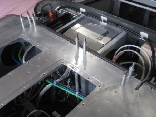

There were 7 rivets I could not get a bucking bar on because of conjestion from nuts, bolts, rods, etc. They are shown below. Van's says to use pulled rivet. They sell a 7/64 flush head pulled rivet they say works great for this skin. So I'll put in 7 of them. Next the tip up canopy goes on.

Forward Top Skin Done
7 will need Pulled Rivets
