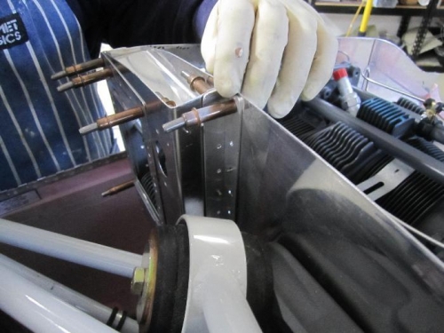

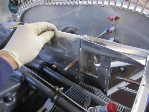

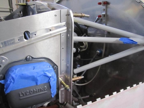

Brief Description:  Baffles 16 Trimming left side rear
To get top cowl fitting right I had to do a lot of trimming above the oil cooler. The outboard part with the spacer/doubler required a lot of trimming. Careful it will jab a dent or even a hole thru the top cowl if you try to jam shot the cowl without removing the material first.
