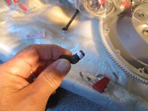

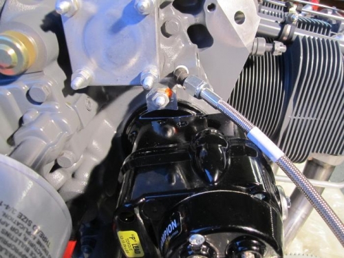

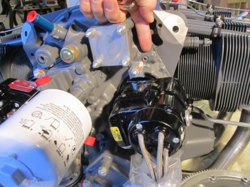

First thing on Van's plan is to install a fitting for oil pressure. I found the port as described.
All fittings going into the engine will get Locktite 567.
Rear Facing Port
Use Loctite 567 on fitting
Face it outward and down 45
