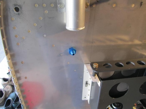

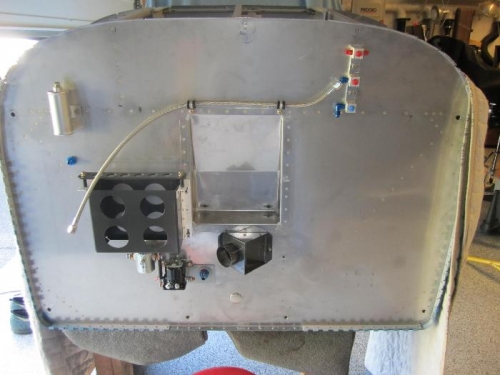

Now I am able to permanetly mount all the parts prepared for the firewall.
Also I drilled the hole and installed the fitting for the manifold pressure per Van's drawings. I hope this turns out okay.
Installed or prepared are:
1. Platenuts for Oil Pressure Hose and Breather Tub
2. Relays
3. Battery Box
4. Cabin heat valve
5. Preassure transducer Fitting
6. Manifold pressure fitting
7. Brake resevoir done a while back
8. Stainless cut out riveted on
9. Top frame parts all riveted on
also
hinges for cowling are riveted along sides and bottom. Can't do these with engine mount on.
