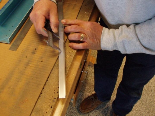

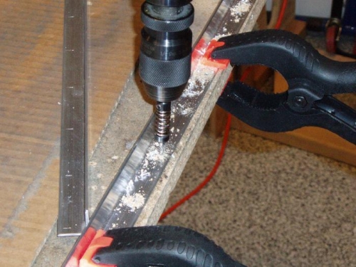

Next I made the angle part for the seat adjustment supports. I cut it to length with hack saw (there I go again wishing I had a chop saw), then measured and marked for the holes per drawing. I used my little centering drill to start the hole, and then finished the holes with the 1/8 drill.

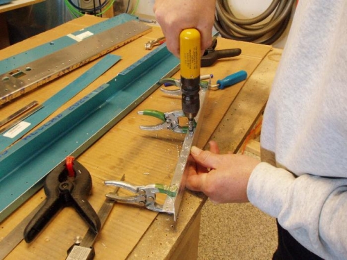

After drilling one, I clamped them back to back and used the first one to match drill the second one.
Measure and mark hole locations
Drill it
Drill it
Match drill the other one
