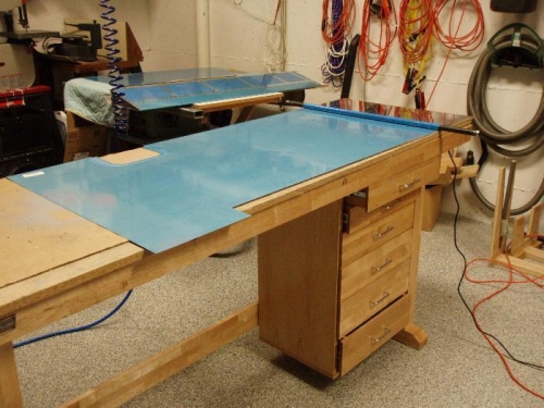

I removed the blue stuff off the bottoms by rolling it off with a pipe.

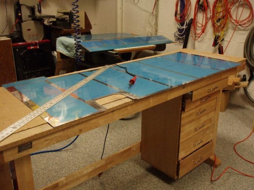

I remove blue stuff in stripes on the top with soldering iron.

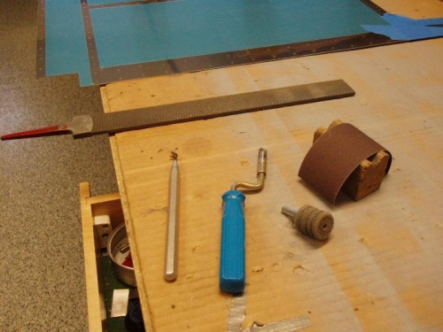

I debur the edges starting with the V-debur tool, and the file to remove large bumps, then hand sand and finally smooth with Scotchbrite wheel.
Use pipe to roll the blue stuff off
Soldering iron to remove stripes
Debur & Smooth Edges
