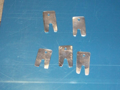

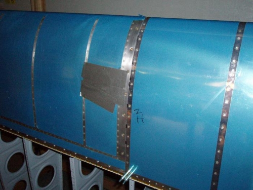

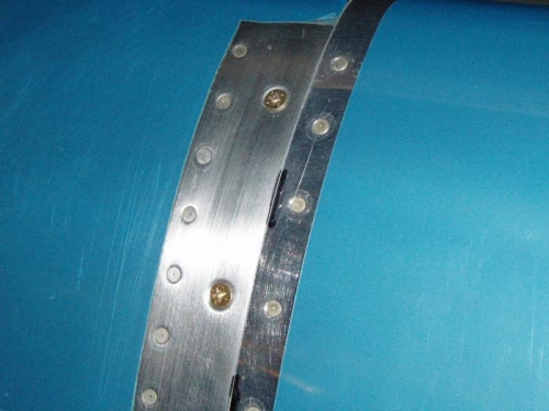

I decided the right LE and tank skin do not align good enough. I appear to have tank pucker between screws and so I've decided to add shims to the LE to make the two skins meet better.
Skin gaps at the black lines
Tank pucker causing skin gap
Little ships to put over rivets of LE
