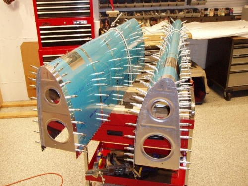

Brief Description:  Leading Edge - Landing Light 1 Locate

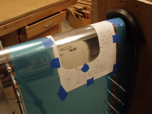

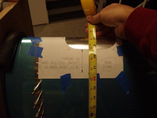

I decided to use the Duct Works 55 watt landing lights. I'll put one in the outboard section of each wing leading edge. Today, I assembled the leading edges with clecoes, and measured and traced the cut out. I'll think about it tonight, and cut out the light access piece tomorrow. Measuring from the trailing edge to light location is variable due to how you hold the tape measure and how many kinks it has in it. So I'm doing both wings at the same time, and being consistant. I gotta be careful of the rivet line, because the forward most rivets are not in the line. I made sure my cutout is parallel with the trailing edge and outboard edge.
Both Leading Edges for lights
Making the cut out trace
Seems parallel to wing
