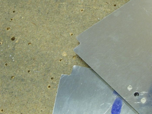

Brief Description:  Tank Prep - Capacitance Fuel Level Trim Plates 2
I trimmed off one corner of the plates for clearance from the stiffners. I did not have to cut the forward corner because I have that stiffner with the veritcal flange foward and so it does not interfere with the capacitance plate.

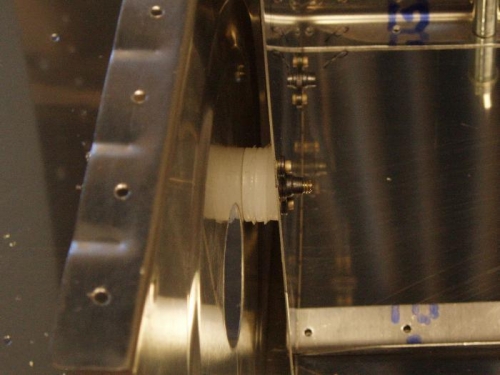

Plate Mounting
Plate Mounting

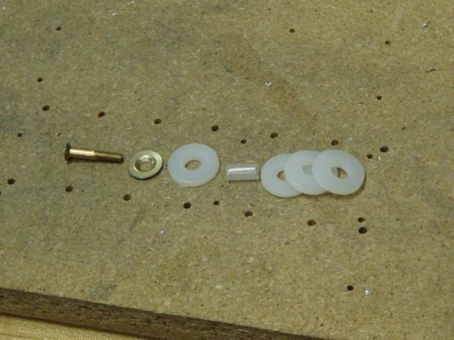

The Mounting Bolt, Washers, Tube
Trimmed Plates
Trimmed Plates
