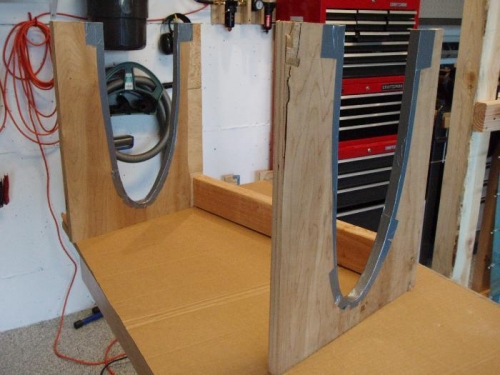

I built the leading edge fixture per plan. I use duct tape as "padding" because it does prevent scratching. Both leading edge skins and ribs went together fine. I had spent considerable time earlier ensure the leading edge teeth on the ribs were orthoganal to the web, straight and smooth.
Leading Edge Fixture

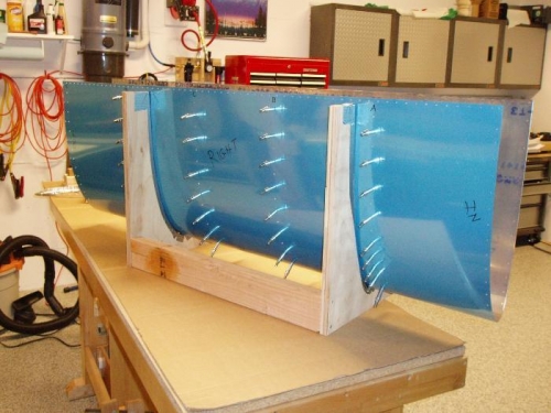

Skin and Ribs
Skin and Ribs

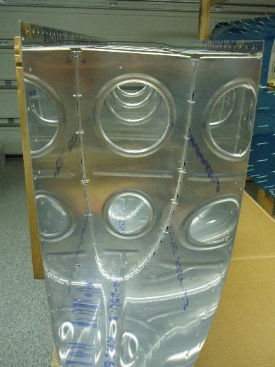

Look at this internal shot
