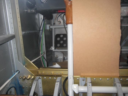

I centered the stick.

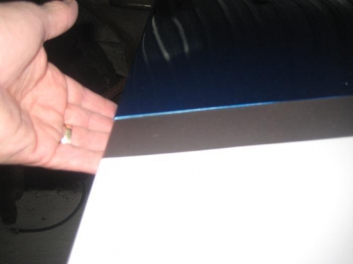

Aileron's were just slight off.
I adjusted just the right aileron so that both line up perfect with the wing tips.
And sure enough the flaps just about line up with the ailerons. They might be 1/8 low, but they are up as high as they will go.

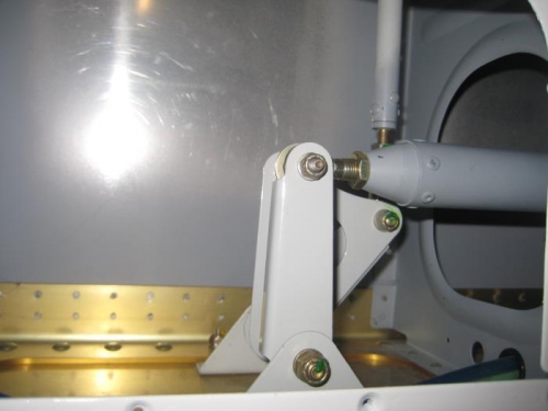

I also made sure all linkages were tight and painted.
Centered the Stick
Centered the Stick
Adjusted ailerons. Both line up.
All linkages secure
All linkages secure
