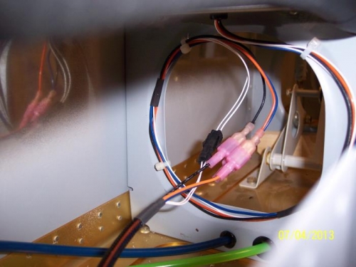

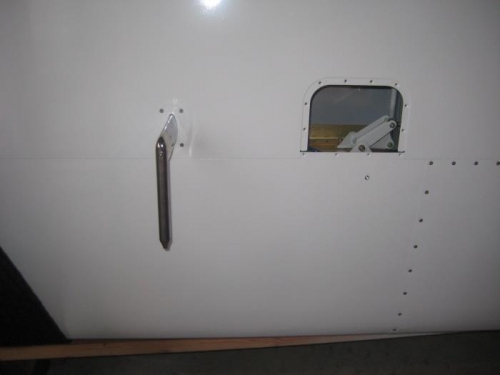

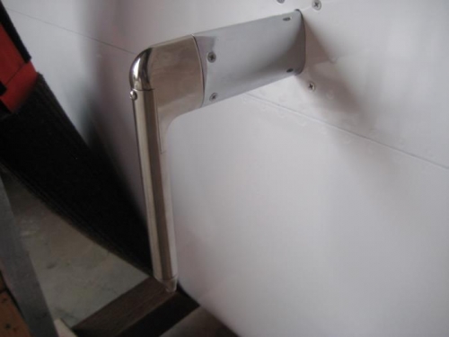

In preparation of mounting the left wing I decided to install the pitot tube first. It is easy to do when the wing is sitting vertical.
Remember this is a new pitot because Van's recalled the first one and sent me this new one. I had to drill and tap holes in it for the number 6 screws. I used a #36 to drill the hole and a 6:32 tap to add threads.
Then I needed to review the wiring diagram to remember which ways the wires hooked up. Basically by color.
