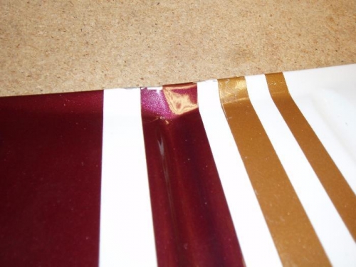

An airplane's wing hit its hangar door yesterday and put a dent in the aileron. We decided to see if my new skills learned on the RV were sufficient to fix this. I consulted an A&P/AI who told the the general fix.

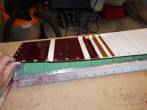

So first thing I did was remove some rivets and open up the skin. Driling out rivets is easy at this stage of the process. Recall at this point I'm 90% complete on structure of my RV-7A.
Oh oh a dent from the hangar door
I little bit of crunch
Drilled out rivets & opened skin
