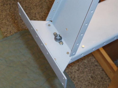

Brief Description:  Rudder - Assembling Frame Plate Nuts

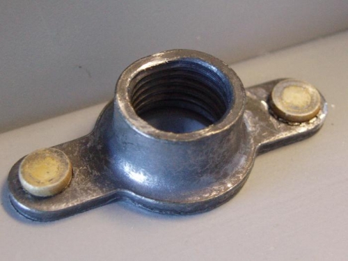

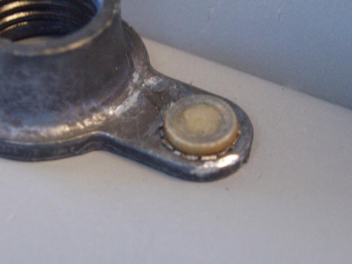

I assembled the Rudder frame today. The root of the rudder has many different length rivets. Notice the photo below the rivet embedded into the platenute. I called Van's and they said this was fine and reminded me that the rivets on the platenuts are merely to hold the platenuts while the bearing bolts are screwed in.
Rudder Horn & Platenute
Close up of plate nut
Macro function on my camera
