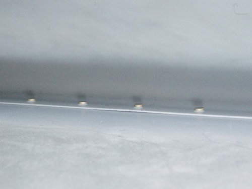

I riveted the skin on the vertical stablalizer. I had one bad rivet that I needed to drill out. It seemed to be because the rivet gun slid off the manufactured head. I tested the rivets with the 3/32 gauge. Seemed good. See the little space under one rivet in photo below? I wonder if that's okay. Can't see anything on the outside.

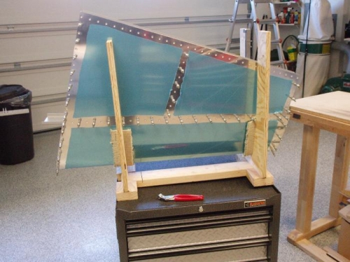

Here is how I hold the skin for riveting.
Shop head of skin rivets

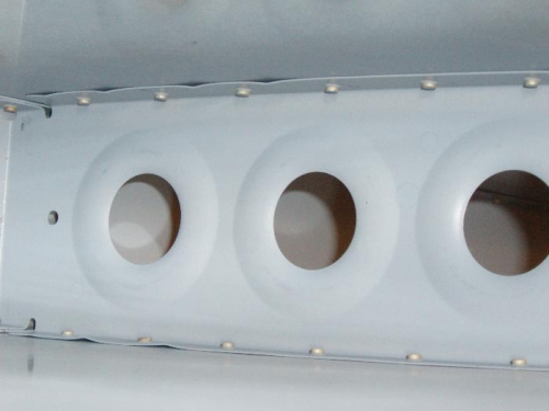

Close Up of Skin Rivets.
