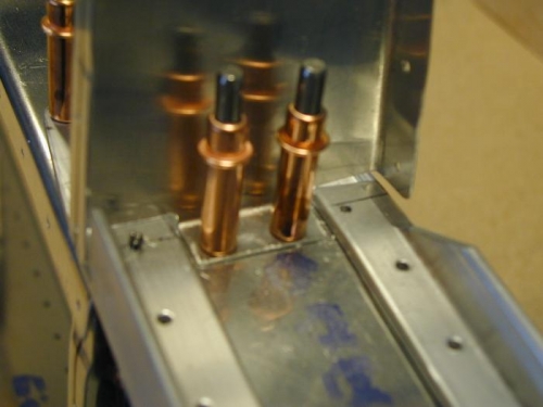

Brief Description:  HS Right Side is drilled
I built up the right side of the HS just like the left. Only issue was this one hole is close to the edge of the front spar support. But measuring shows the edge margin to be 1.5 D or 6/32s and it is not thin skin, but rather the thick support, so I'm calling it good.
Close edge margin, but called good.
