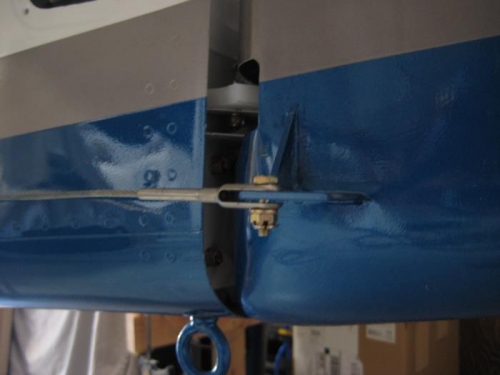

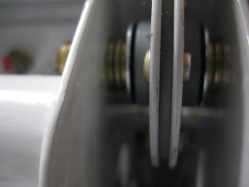

I installed the two bolts thru the elevators. One goes thru the push rod and the other goes thru the bearing attached to the HS. The bolt thru the push rod was easy. Getting the washers on the bolt thru the HS was difficult. I should have done this before putting the vertical stabalizer on. I was able to do it by removing one of the stabalizer hinge pins which let the stabalizer move rearward so I could put the washers on and then slide them into place. I put two large washers on the right and 3 on the left. All the gaps are filled.

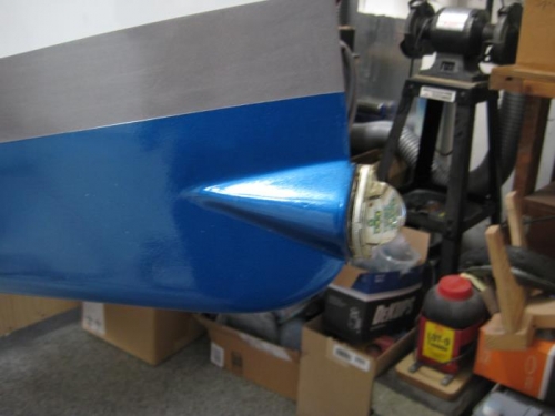

I attached the tail light.
I attached the rudder cables with crown nut and cotter pin.
I tighted all the bearing nuts and marked everthing with latex paint as a reminder.
