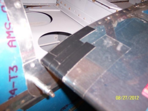

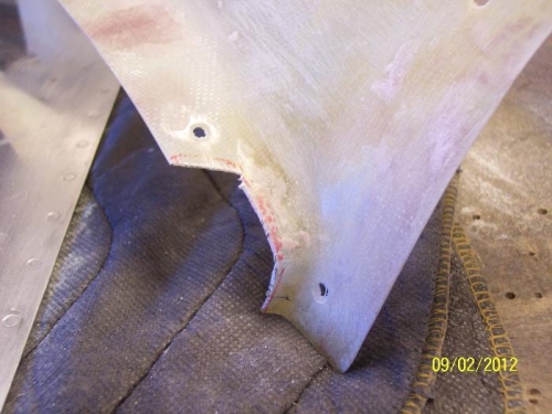

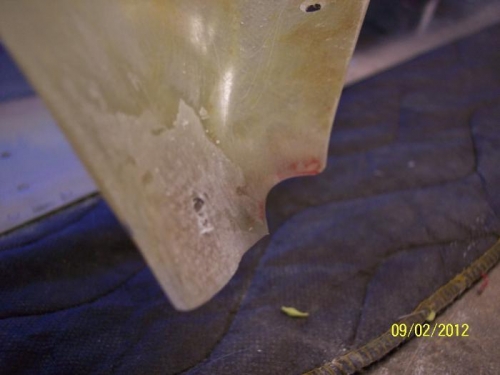

I cut off the material that doesn't fit with the plan to replace it using the HS as the mold. I covered the HS with black tape so the fiberglass doesn't stick.
Cut off bad material
Other side gets some stuff removed
Black tape put on HS
