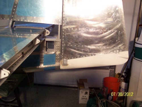

I put the plastic tip on the airplane and marked where to trim off a little height so that the bottom of the tip is in line with the fuselage. I cut off only about 3/8 inch.

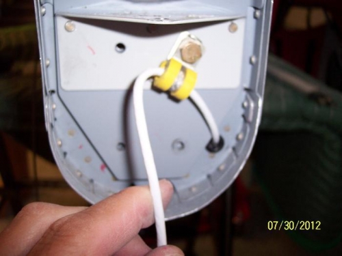

The tail wire exits the fuselage low. Then plan to use an adel clamp to hold it below the hinge. From here the wire will drop into the plastic tip.
Bottom of tip in line with fuselage
Light wire goes into plastic tip

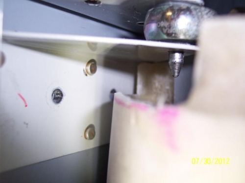

Might have to lower this
