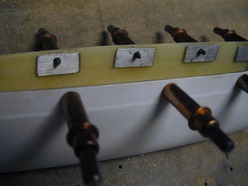

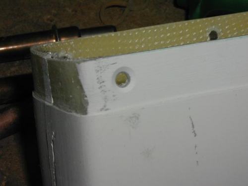

I counter sunk the holes on the plastic tip. Then I pondered if I needed aluminum strap the length of the rudder to hold the rivets. I decided to use aluminum strips instead of full length strap.

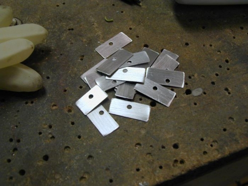

I made a pile of strips. Drilled them. I glued them on with epoxy glue and clecoes to hold them in place while the expoxy set.
Counter sunk
Counter sunk
Aluminum strips
Aluminum strips
Glued in place
Glued in place
