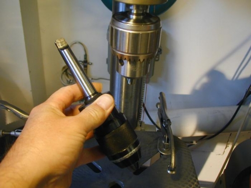

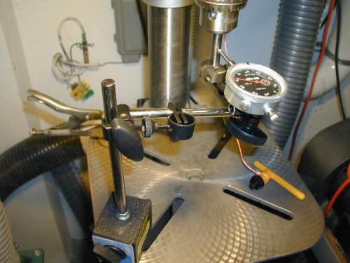

When I started this project I needed a drill press and forgot to mention I bought a floor standing Sears Craftsman drill press. Well it has worked okay, but it bugs me. Because the drills have never spun true. The wobble. I bought a measuring tool from harbor freight and discovered all me bits wobble about 11 thousands (0.011). Well that is too much. About a year ago I bought a new arbor and chuck from Sears, but guess what? It was bad also. It is just the level of quality or something.
So I got out my measuring device and discovered the arbor spun true. It spun with less than 1 thousand variation (0.001). So that is good enough. I decided I needed only a better chuck.

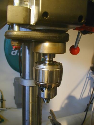

Well there are chucks for sale for $400 bucks but I could see spending that. I ended up with a keyed chuck from Grizzle for $50. They call it their precision chuck. And it is. It spins my drills within 4 thousands (0.004) variation. So finally this thing is working okay.
Advice: I would look for an old factory drill press before buying a new one. And I read the reviews more before spending the dough. I see better reviews about JET drill presses. Also I think the keyless chuck tends to be less accurate than the keyed version. Just my opinion.
In accurate keyless chuck

from .011 to .004
from .011 to .004
New keyed chuck seems to spin true
