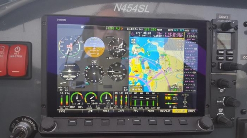

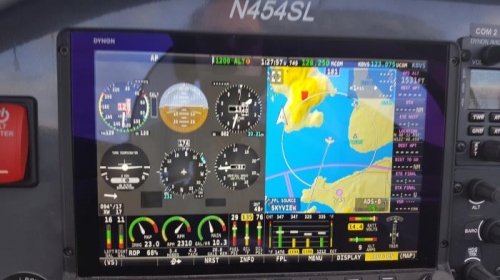

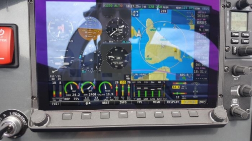

Here are some more numbers. Note these are with OUT wheel pants and leg fairings.
Photo 1 is 25 x 25 or 25 squared. Notice 140kts with 12gph burn.
Photo 2 is 24 x 24. Note 138 kits with 10.9 gph burn.
Photo 3 is 23 x 23. Note 120 kts with 10.4 gph burn.
Later I'll compare these to with wheel pants, etc.
