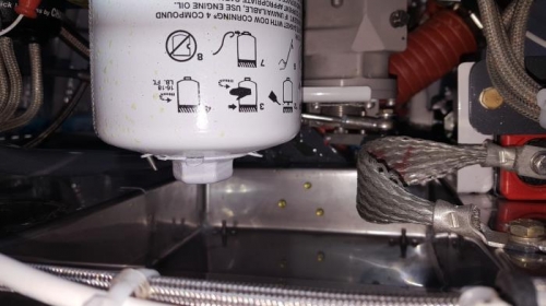

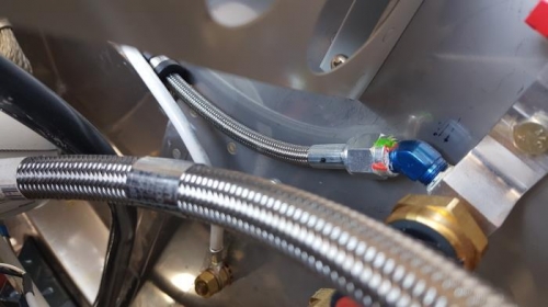

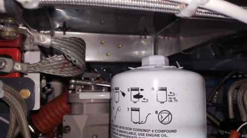

Another issue after flights one and two was an oil leak. It showed as just drops. It took me a long time to find it, but I did. It was where the oil line goes into the transducer for pressure. I gave that nut a little pressure and it turned 90 degrees sealing the connection. Oil leak gone.
The only issue now is the slightly high EGT on #3. I cleaned and tested the spark plugs and have switched one of the plugs to #1 to see if that changes anything. If not, I'll swap the probe and see if the high reading follows the probe.
Oil leak drops
Oil leak drops
Oil drops on filter too
This fitting right side was loose
