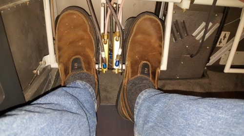

Another change from the first couple of flights is to the pedals. With the pedals as they are it is hard to hold left rudder pedal and push on the right brake without also pushing on the left brake. There is just not a good way to push rudder without also pushing the brake because they are flush.

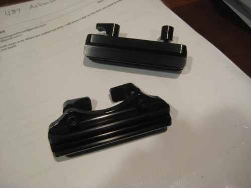

So I ordered a couple of aluminum blocks for the pedals. These make the rudder pedal stick aft more and fit onto your shoes so you can easily push the rudder pedal without your toes also pushing the brake. These have really improved my steering around on the ground. These are a mush.
Brake Pedal Extensions
