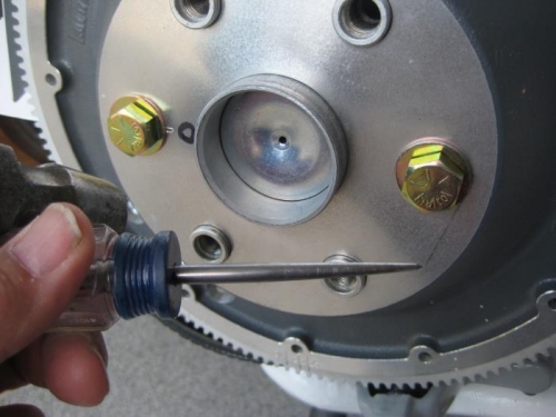

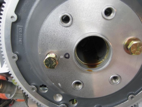

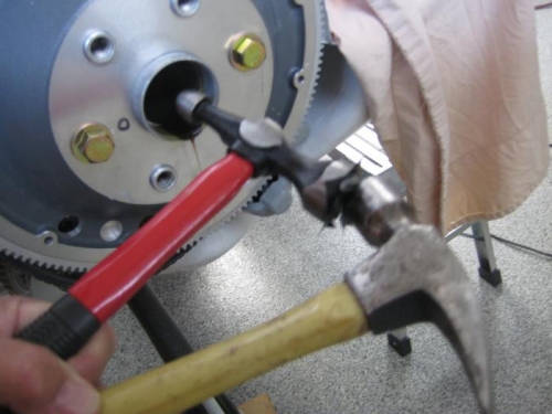

Time to put the prop on for the last time. First I gotta remove that inner cap. I punched a hole in it. Then I banged it with a hammer which made it concave and come out easily. Some oil leaks out.
First punch a hole
Bang it with a hammer
it comes out. Oil too.
