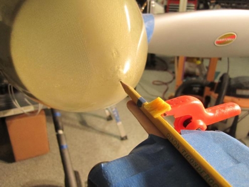

You have to make sure the spinner is on straight so I put a pencil in front on a stand and spun the properllar. The center seemed stationary so that is center.

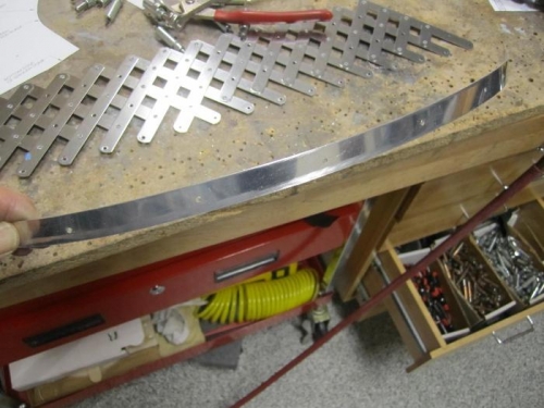

Then I made a template of half the propellar circumference and drilled the 14 equally spaced holes. I used this as a drill template to drill the spinner to the backing plate.
Centering the Spinner

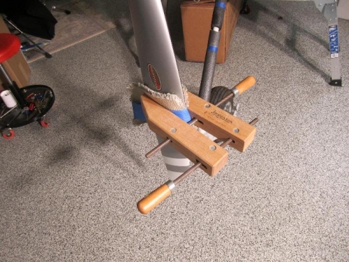

clamp for twisting
clamp for twisting
Template for Drilling
