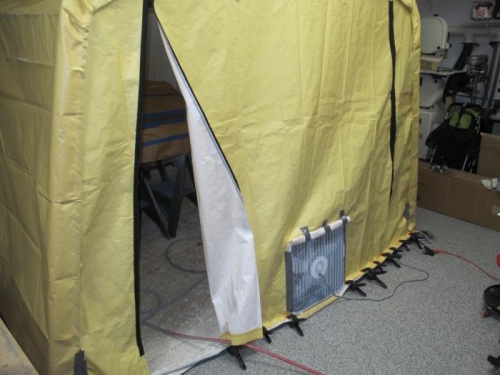

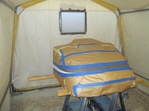

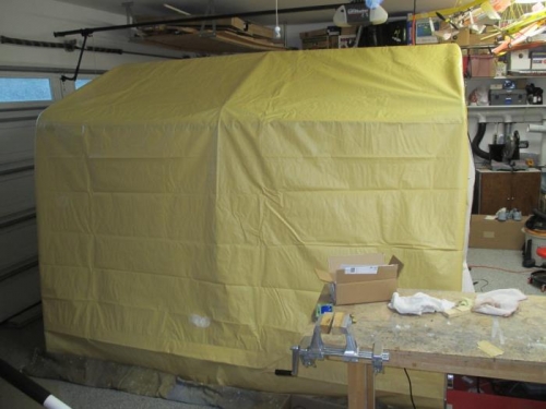

I have to repaint the lower cowl because the stripe is in the wrong place. So I made a paint booth at home and did the painting. The tarp is a 10x10 shed from Harbor Freight. Cost about $69.
I sealed the floor with a canvas tarp. Taped all the edges shut. Put in a fan and exhaust hole with a filter. Everything worked okay.
