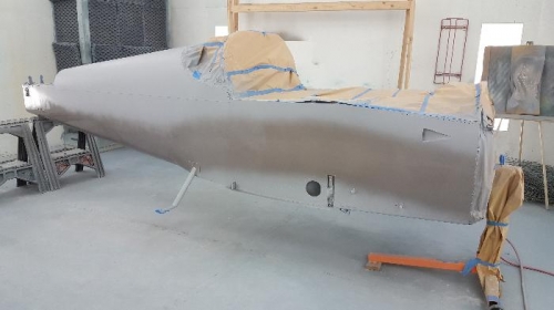

I painted a grey swath where the 2 inch grey stripe will be. I paint this first then tape off the 2 inch portion and paint the white and blue. This makes for a lot less taping effort.
Grey line in there someplace
