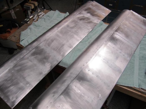

After removing the flaps, I slightly buff the rivet lines with grey Scotch Brite in preparation for filling the rivet heads with glaze. Then I wipe the lines with Acetone.

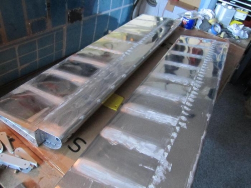

I mix up some glaze with hardener and smear a dab on top of each rivet. Goes fast. I push hard. The point is not to fill the rivet head flush with the skin but rather to smash some glaze down around the flush rivet head so the primer and paint looks smooth.
Then I sand the line of rivet heads. This is messy. And I rub the whole thing with grey Scotch Brite to create scratches for a mechanical bond with the etch primer.

Fill in the rivet heads
Sand
Sand
