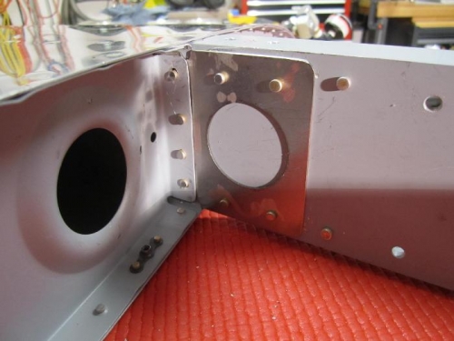

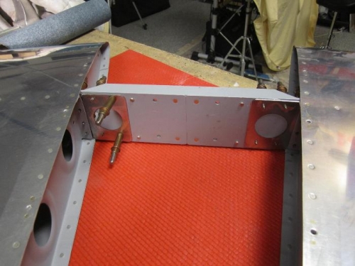

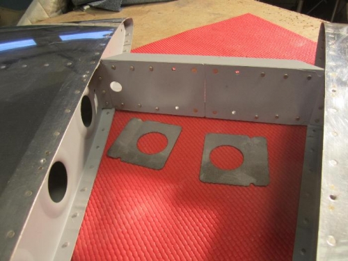

The next part to get painted was the horizontal stabilizer. Before painting it I decided to put in the stainless steel fix for cracking spars that some have had trouble with. I might as well put these in now while the airplane is apart. It is easy. Or so I thought. Riveting was not as easy as I remember because the ribs and skins are in the way. But it got done.
