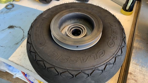

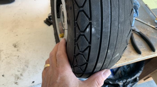

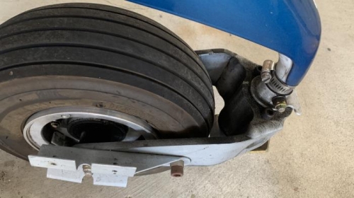

The tires were getting worn on the outside due to the cant in the legs. So when I repacked the main gear bearings I reversed the rubber on the rims.
The nose gear is fine and has a sealed bearing so no repack is needed.
Wearing on outside
Reversed on wheels
Nose is fine
