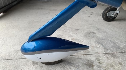

Next I put the nose pant on. I had to think about where would the tow bar fit to pull the airplane. I finally realized the holes for the fairing bolt needed to be enlarged to accept the tow bar onto these bolts. I have been pulling be the axel bolts. I think these bolts forward of the axel may make pulling and pushing a bit easier.

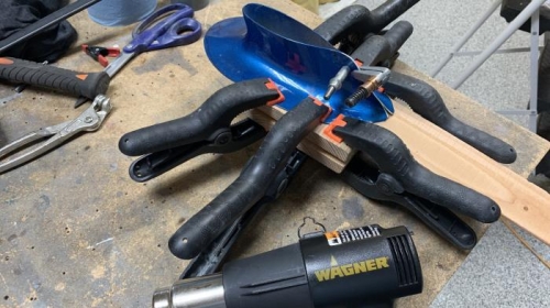

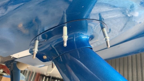

The leg fairing and the nose pant went on fine. But I had never finished the intersection fairing at the top of the leg fairing to cowl interface. It did not fit well. I need to trim it and reshape it.
The shape was so rough I almost decided to make a new one with custom fit, but first I tried to reshape it with heat. Turns out that works a bit. I clamped the little fairing in place on a piece of wood and applied heat. Then let it cool. The fairing changed shape and stayed changed after cooling. I was able to make it shut fully and then bend it to flat and finally I made an indention for the lower cowl plate.
I used platenuts to install the final nose gear transition fairing. I did not have to remove cowl to do this. i used pulled rivets to attach the patenuts.
You need the top fairing in order to hold the leg fairing. It is either all or non for the nose gear.
Leg and nose went on fine
Reshaping with heat
Reshaping with heat
