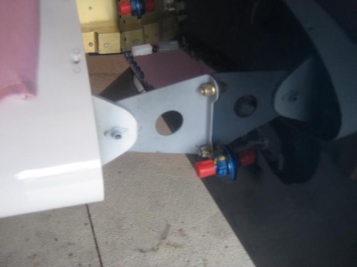

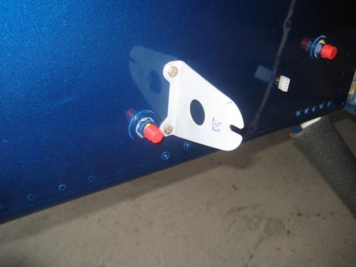

To finish installing the right wing I next installed the tank holding bracket.

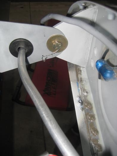

This bolt doesn't get fully tighentened. The big washer needs to be slightly loose. There is a slot that allows the forward part of the wing where the fuel tank is to move a little.
So you need to safety wire this bolt. I drilled a small hole in the bracket for the safety wire.
This is left side
This is left side
Right side

Right side rear safety wire
