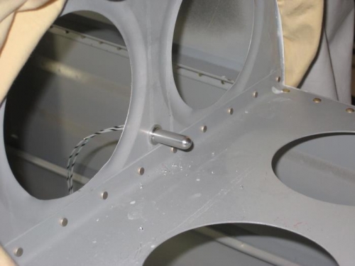

To mount the ADAHRS, I had to first mount the outside air temperator OAT probe. I decided to mount it in the tail cone above the turtle deck. This will feel outside air. No blowing air. No sun affects. And I don't think it will feel any cabin warming, because it is too far away from the cabin and has too much ventilation going on. I'll leave the full length of wire and move it later if this doesn't work. I see others have put it here with great success.
I installed the connector to the OAT probe after routing the wires to the back of the ADAHRS.

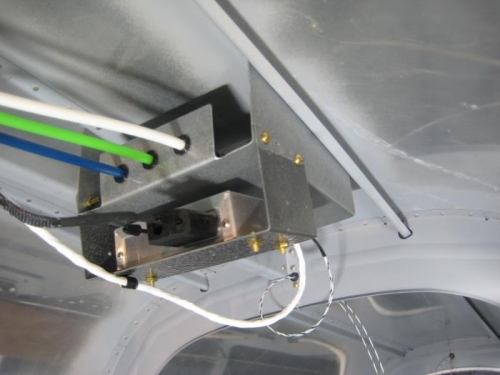

I mounted the ADAHRS. I cut the tubes which had been previously routed and installed them in their connectors. I routed the Network cable and plugged it in.

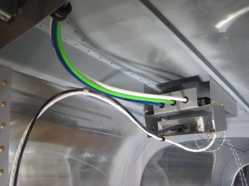

Then I mounted the Magnetometer. I plugged in its cable.
Then I added a couple plastic adel clamps with brass screws to hold the cables. These cables go to behind the panel. I still had room in the main wing spar holes for these wires. So far I have not had to drill extral holes in the spar web.
Outside Air Temp probe
ADAHRS on op, level
ADAHRS on op, level
Magnetometer on bottom 7 degrees down.
