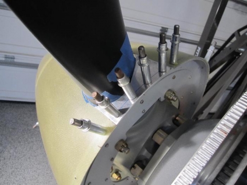

Brief Description:  Prop Install 10 Spinner Cone Back Filler Plate

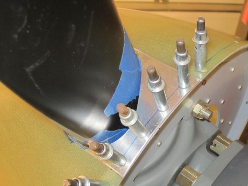

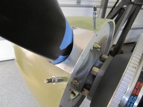

The back of the prop gets a cover plate to hide the gap there. It is made out of 0.062 alumium supplied by Van's. It is pretty thick. I started with a paper template until it was close then made the aluminum pieces. Again it was an iteration of try and sand until final shape fit with about an 1/8 of clearance. My clearances are pretty tight. I hope not to tight. I also twisted the prop again to make sure clearance include full range of motion of the variable pitch prop.
I have to come back and make the backing piece for this gap seal.
