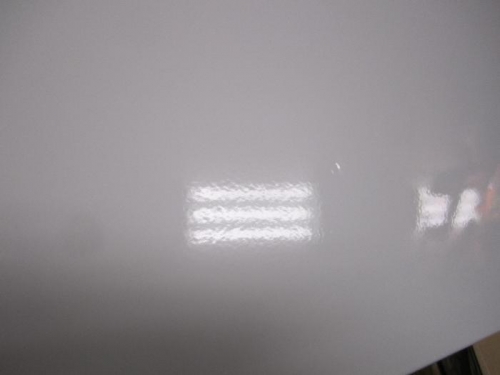

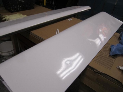

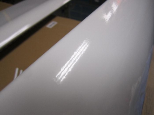

You can kind of see in photos below the first one has more orange peel texture then the second one. The first one is on part of the flaps that was hanging vertical and the smoother photo 2 is of the curved forward part of the flap that was hanging flat. I think putting the parts flat lets gravity smooth out the paint more. I've gotta go for flat in future.
But these are still pretty good.
Slight ripples (Orange peel)
Very little ripples
Very little ripples
