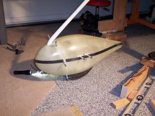

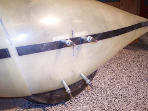

Then I worked on the nose part of the pant and trimmed out a hole for the gear leg. No photos of that. Eventually I trimmed enough I could put together the 2 halves. I made it level and drilled the fastner holes.

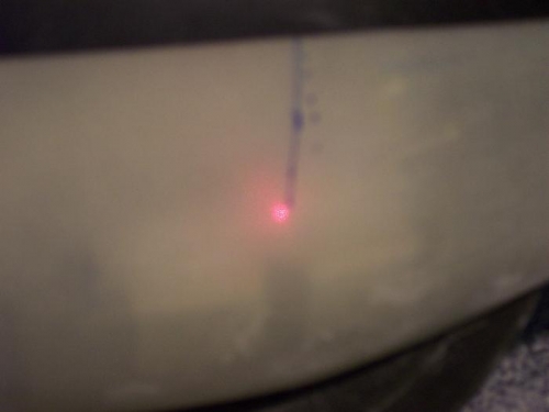

I had to locate the hole for the pull bar and so I set up a laser on the bolt with the pant off. Then put the pant on and drilled the red dot. Worked just fine and hole was right on location of the bolt that the tow bar will connect to.
Drill here for tow bar access hole
Drilled fastner holes
