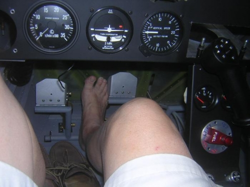

Date:  5-14-2007
Number of Hours:  1.50
Brief Description:  Brake Pedals
After I sat in the plane and tested where my feet were in relation to the foot pedals, I decided to move the pedals fwd about 2-3 inches. At first, I thought this was going to be a major problem, requiring the removal of existing brake locations and moving then forward to accommodate the pedals being moved. But to my surprise, the pedals were moved forward by 3 inches with just a 20mm movement of the steering pushrods. Also, the location of the brake cylinders were barely affected by the movement.
