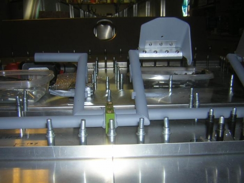

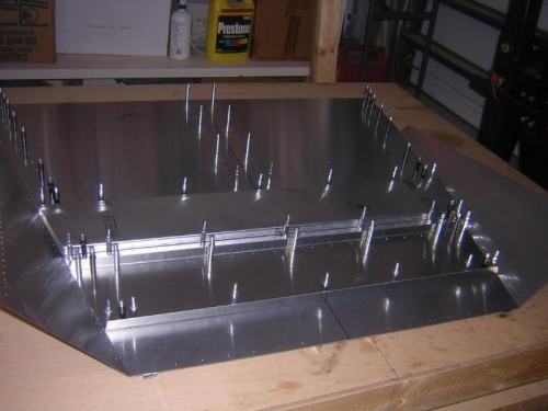

The cabin floor is built up separately from the main fuselage until fully assembled. Both the heel plate and the rudder control tray and placed onto the cabin floor and clecoed in place. After attaching the bearing supports and the nylon center, I sprayed 7220 primer over the rudder controls and the toe brake pedals and then followed up with an aluiminum shine paint on the toe brake pedals. After these parts were in place, I started on the Center Wing Spar and Jig.
Rudder tray support and heel support

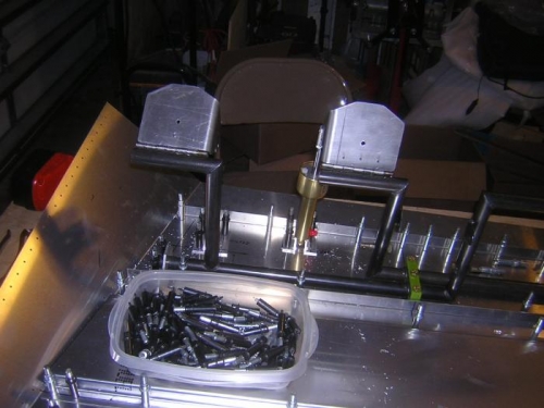

Rudder Pedals and Toe Brakes
7220 Primer and Dupont Aluminum paint
