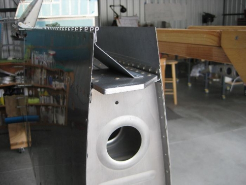

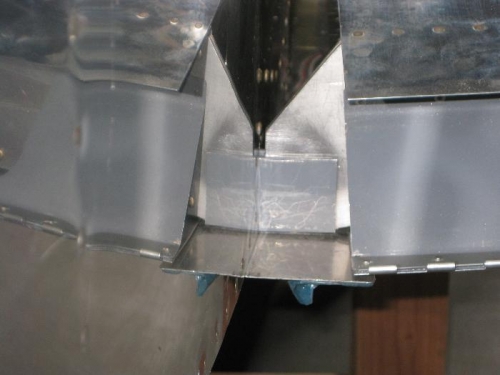

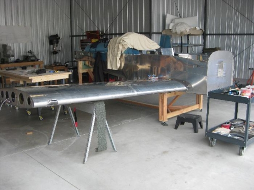

We slid the first wing in place and discovered the aft spar was hitting the fuselage and prventing the forward the spar to slide all the way into the aircraft. We pulled it back out and figured out that Vans did not trim the aft spar on the QB wings. I thought they had. So we quickly checked the plans, marked the spars on both wings and trimmed them to size. We slid the wing back into place and it fit like a glove. No pounding, no extra pressure; it just fit. The drift pins I created just about slid into pl
Rear spar
Rear spar
Wing installed
Wing installed
