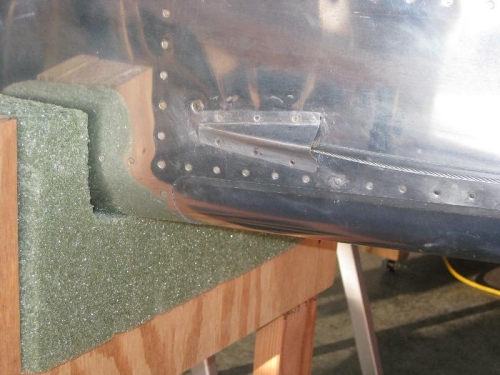

The cable fairings were dimpled, but the fuselage skin was not. Using a special tool I got from Averys I was able to dimple the fuselate skin to accept the fairings. Riveting was completed quickly. On the inside is an Adel clamp that holds a plastic tube in place. You can not see it from the photos but that also was installed on both sides.

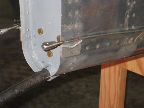

Next was the rudder stops; drilling, deburring, countersinking and riveting. I am assuming there was a small amount of movement during the riveting process. The stops are a little large so any movement can be handle by a small amount of sanding. I will double check once the rudder is back in place.

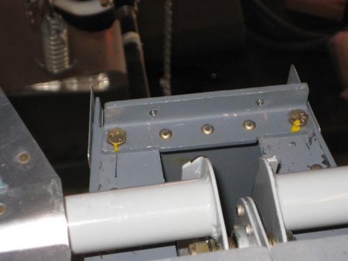

Finally there were three rivets on the elevator up stop that I could not reach with the Vertical Stabilizer in place. I finished those day as well. The Horizontal Stabilizer is back on the aircraft. I plan on torquing those bolts tomorrow.
Right rudder cable fairing
Left rudder stop
Left rudder stop
Elevator up stop
Elevator up stop
