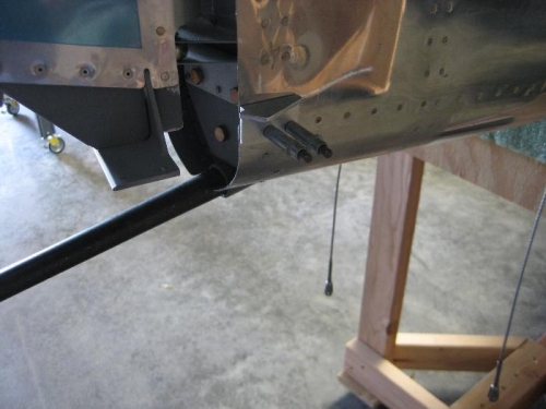

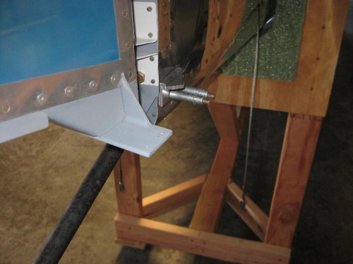

Yesterday and today I had a couple of hours after work to dedicate to the airplane. I fabricated a second rudder stop for the right side of the aircraft. Using the same block method to determine the correct distance from the elevator I removed just a slight amount of the stop. Both are now ready for riveting.

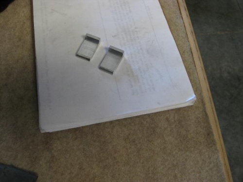

I also fabricated the two aileron stops. I need to drill the rivet holes and then go through the process of determining the correct amount of up travel. Maybe this weekend.
Right rudder stop
Right rudder stop
Aileron stops
Aileron stops
