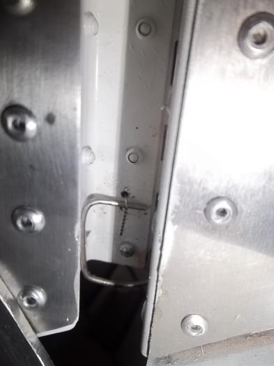

Brief Description:  Reassembled to the fin and safety wired
Reassembled the rudder to the plane. I had already placed a loop in the hinge pin, but until now had now way to secure it. Drilled a couple of holes in the hinge flange and used them to safety wire the hinge pin loop. The loop will make ite easier to remove the hinge pin for service.
Hinge pin safety wired.
