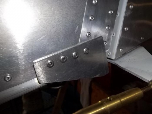

Brief Description:  Fabricated and installed new rudder stops
I originally installed my rudder stops too short. The rudder pedals were being stopped by the arms on the nose wheel strut rather than the stops. I removed the stops and used them to fabricate replacements that extended a bit more aft. I may have made them slightly too long, but it is easier to file down material than to add it. Will recheck rudder travel during final rigging.
New rudder stop
New rudder stop
