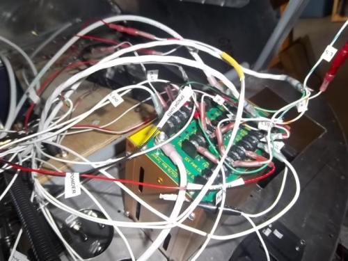

Brief Description:  Continuing to wire panel
Continuing to wire up the panel. Today I hooked up the following to the respective power/ground/switches, but have not connected the remote heads to the com/transponder:
1) ADAHRS
2) COM Radio
3) Transponder
4) Flaps motor and switch
5) Viking View and Tach power
6) Wingtip Nav and Strobe
7) Heater
Right now it looks like I'm just building a new rats nest, but once everything is connected, I can start organizing into looms and get things tied off. I'm also continuing to label the wires so I can easily restore everything when I get the final panel cutout.
A partial list of things still to do includes:
1) Trim
2) Fuel Gauge
3) ELT
4) Ship power for the tablet
More stuff going into the power panel
