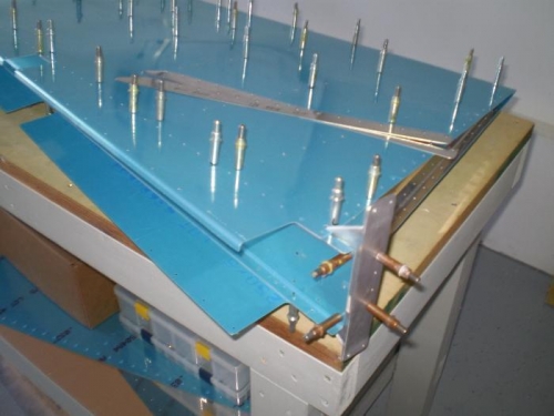

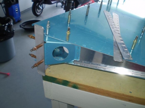

Today I clecoed all of my rudder pieces together. I fabricated the rudder horn-brace shim and the attatch strips for the bottom rudder tip. The rudder will still need to be match drilled, dissassembled, deburred, dimpled, primed and riveted.
