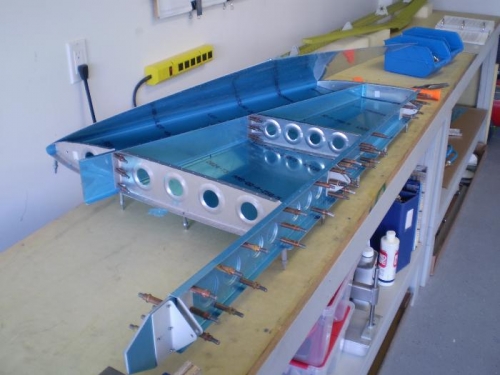

Brief Description:  Beginning the horizontal stabilizer.

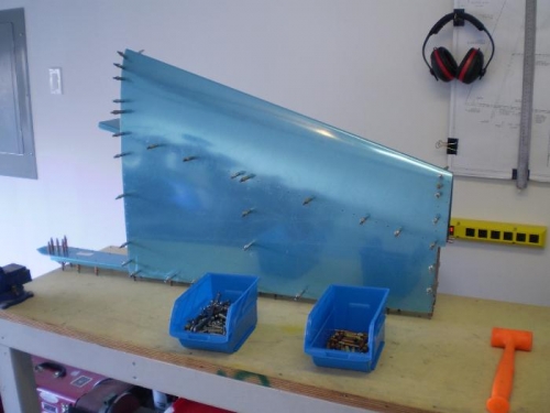

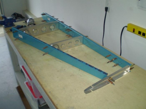

I decided to take a break from the horizontal stabilizer and begin assembling the vertical stabilizer.
I clecoed the pieces together, did dome match drilling and started finishing the edges of the skin. Ive been using a file, some maroon scotchbrite and a few scotchbrite discs on an angle grinder to do most of the edges. These things work well but are quite time consuming. I think I will get a bench grinder with a scotchbrite wheel soon.
