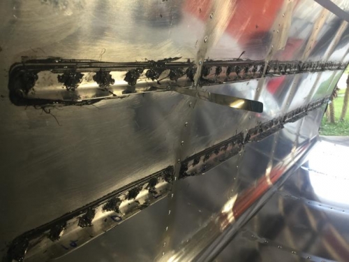

Touched up Left Fuel Tank Stiffeners and Drain with Proseal. Added a better fillet to the stiffeners and made sure all the rivet shop heads were covered well.

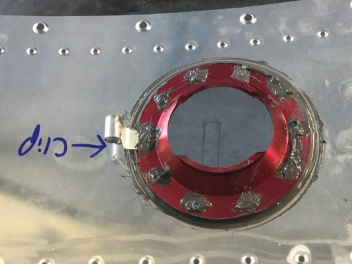

Drilled out 3 rivets on Fuel Cap. Made a new Vent Hanger. Riveted and sealed all four rivets.

Installed -6 Rivet into outboard End Rib Aft Hole with Proseal. No issues.
Finished sealing Stiffeners, Drain, and Cap
Fuel Cap and Vent Clip Sealed
