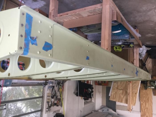

Riveted all the Main Ribs of the Left Wing onto the Main and Rear Spars.
Mounted assembly to Wing Stand. Spent a long time leveling and securing it to the stand and trying to get the shop setup so I can work without bumping into everything.
Clecoed on all four Main Skins.
Had to drill out several rivets on the Tip Rib. Kept getting a gap. Finally acceptable. Also, found a bad rivet in one of the Root Rib where it rivets to the Main Spar Web. Will drill out and replace tomorrow.

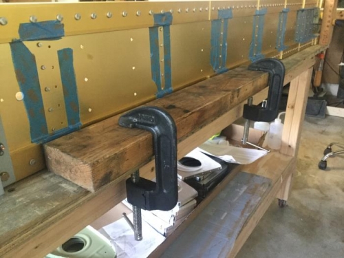

Ribs Riveted to Main Spar
Ribs Riveted to Rear Spar

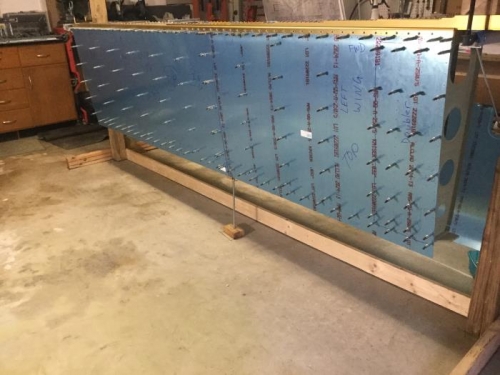

Skins Clecoed
Skins Clecoed
